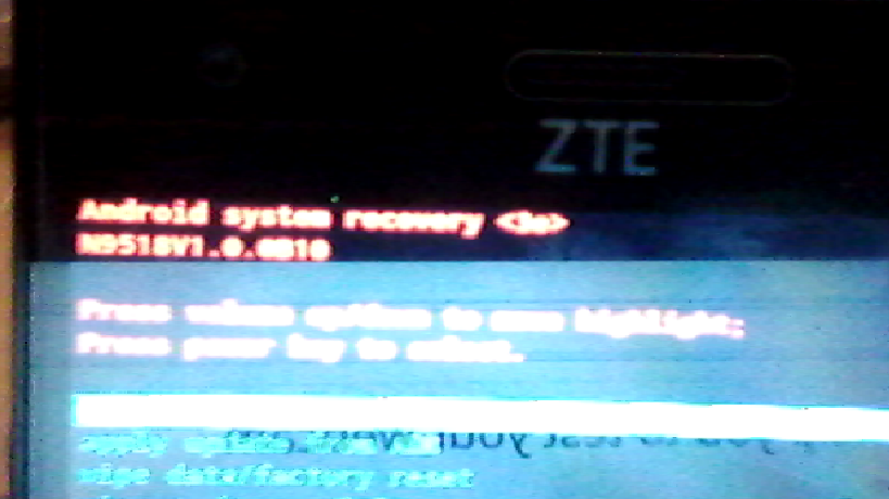

Hey, I think that I might have found that recovery mode (yes I'm using a ZTE Warp Elite N9518)that you're looking for...
I'm not sure if it'll be of much help if you've already found it but how to get to is is by:
1. Hold power button and volume down keys until phone shuts off (it will take a screenshot first but ignore that)
2. Keep holding until ZTE logo appears, at that point release the power button but keep holding volume down button until the menu that can be somewhat seen in my super shitty picture appears

Yes that's exactly what we are looking for I'm thinking that the command I used may have done that however I'm still unable to change the permissions in the system directory
Your system may indeed be write protected, ZTE has done that with other models before. The whole system was write protected on certain models so any Modz need be done via recoveries with those deals. You can't just uninstall bloatware on write protected systems, you'd have to build & install a custom recovery, then make a backup & pull a stock ROM to deodex, debloat &/or customize.. then reFlash with recovery. If the bootloader isn't massively locked down, I can make the kernel insecure & add init.d support (add a few scripts if you'd like). I'm gonna put it like this, if anyone gets Root and sends me the files I need below I'll build stock ROMs with any/all deBloating requested.

Okay, so I tried that and once I got the command prompt adb connected to my phone and directed to the location of the update.zip I used
"apply update from adb" on my n9518
then I used "adb sideload update.zip" on my pc
and my n9518 said this
Now send the package you want to apply to the device with "adb sideload <filename>"...
Finding update package...
Opening update package...
Verifying update package...
E:footer is wrong
E:Signature verification failed
Installation aborted.
Do any of you know where I could find the android 5.1 update.zip file specifically for the n9518?
I'll keep searching for it in the meantime.
