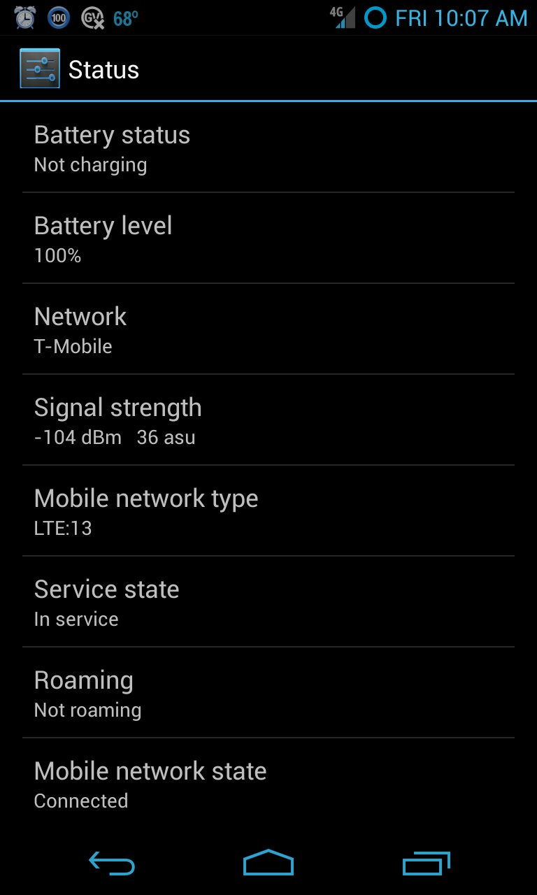

It seems here in jax lte is open, I woke up to lte signal on my phone, here at home the signal is weak. shows -118 db and no bars but its connected.

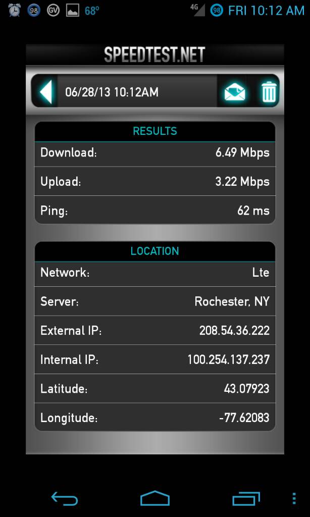

I went from ~6mbps to 11mbps. But I know T-Mobile is all over place, so it may be worth nothing...
Speeds aren't anything to write home about, but it will get there
Looks like my house, no bars sub 10mbs down sub 4 up:p
But find stronger signal and it goes up significantly.
Just ran another test in a 3 bar zone, and got mid 8mb down 7mb up. It's the first day it's shown up, so I'll give them a break for now.
