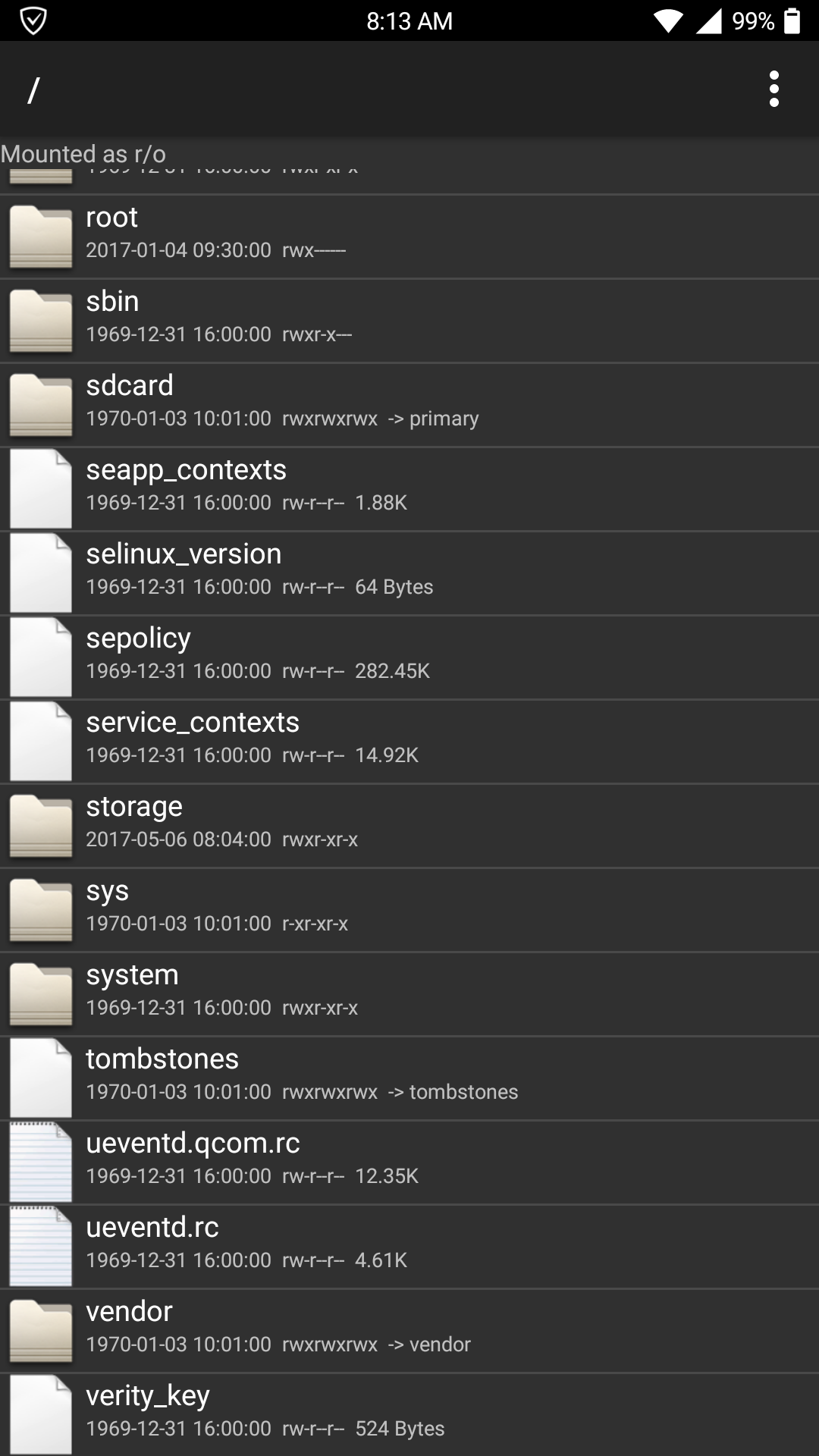

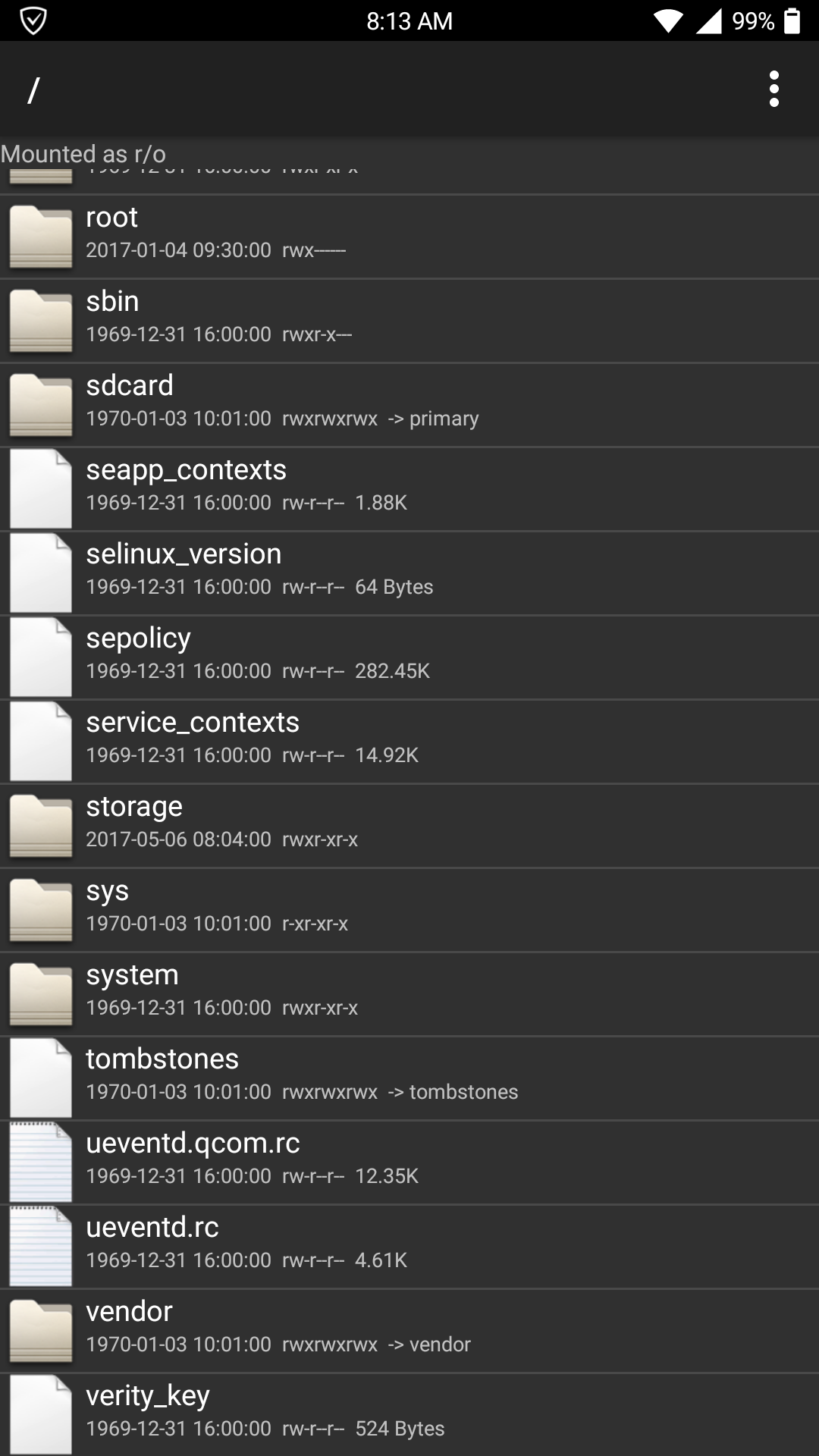

this may have been covered already but when i try to flash superuser,zip via sd card update..the no verity error comes up ...now i see that file is located /verity_key
