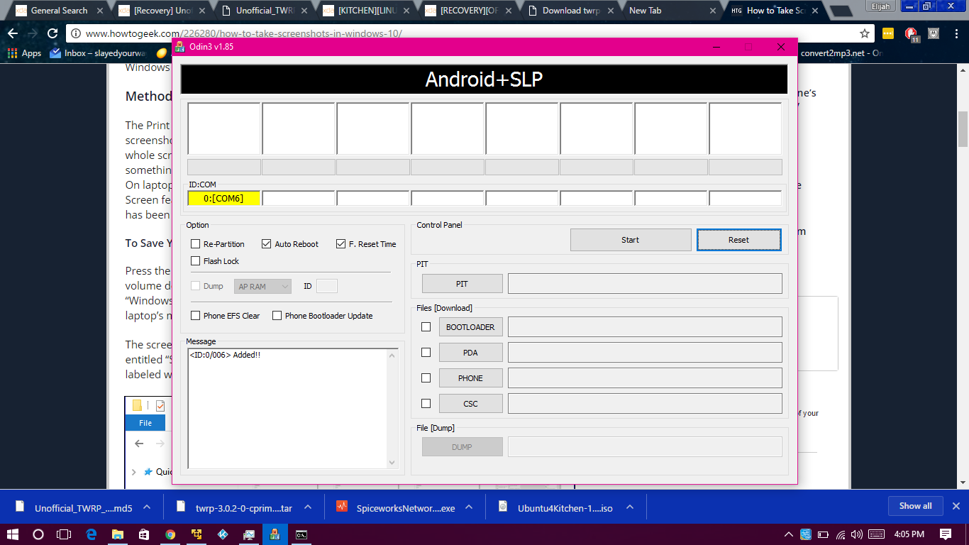

I put the device in download mode and plugged it in after messing with my core prime in odin. However I unplugged the galaxy core prime and never closed odin. When I plugged the device in it was recognized. Here's a pic
