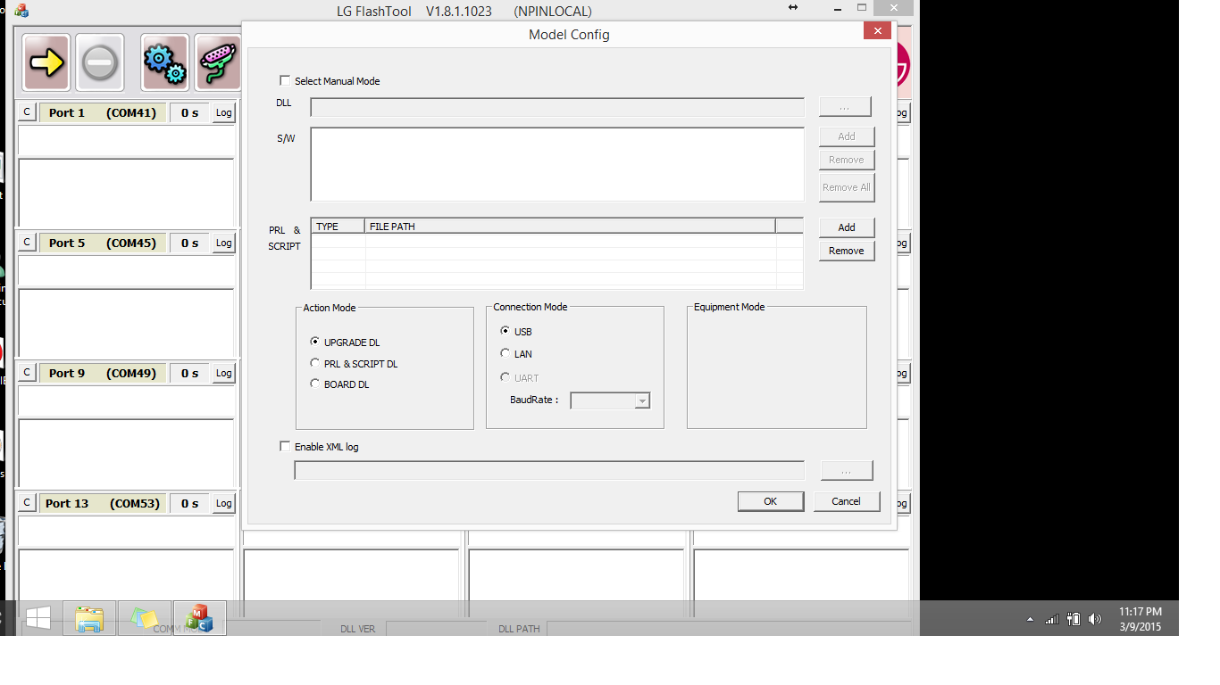

You flashed with the incorrect mode. Reflash with BOARD mode. See the screenshot.
I end up getting this far with the LG Flash Tool.

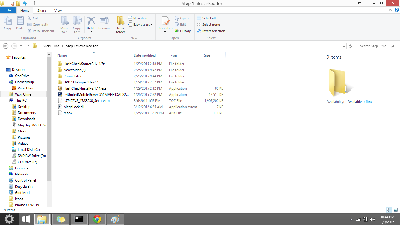

These are all the files I was told to get from step 1 I THINK don't quote me on it different people tell me different things.
So IF this is all I need to get my phone rooted could someone tell me what to put where?
