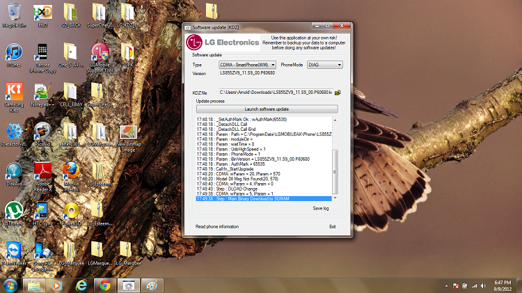

Ok so I followed everything to the letter. Got the S/W Upgrade screen with no problem. I am doing this so i can be able to root my phone. But it got stuck there for like 20 min.
The problem is the battery....this happens a lot where the phone wont reset and it does have something to do with the battery, I know this from unbricking OVs....it's very frustrating because I have found the only solution to this problem is using LGNPST to unbrick....which is also a bad way to unbrick because data programming gets erased...
