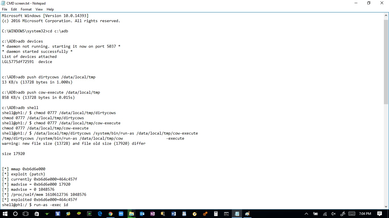

With only you two so far attempting this, please, don't give up, backtrack, start over & create ADB on your computer, unzipping the .tar files contents into it. Make sure you have admin on your cmd screen (control + shift before clicking to open command screen), and it will (see text copy from my CMD screen) execute the dirtycow Xploit.

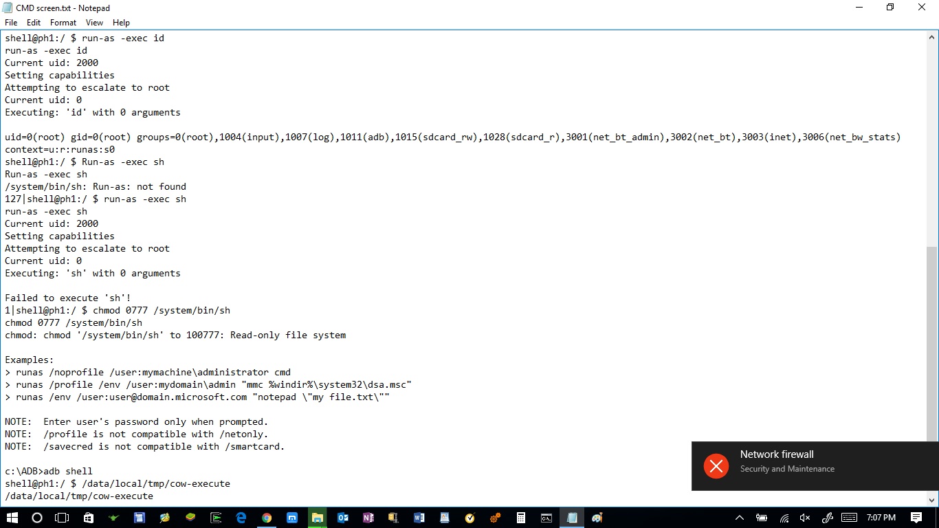

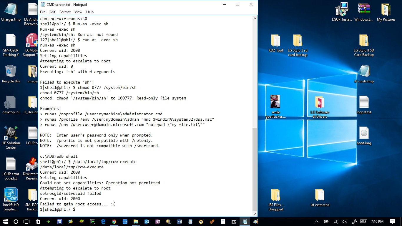

here is what I get:
C:\Users\Donny\Pictures\Logitech Webcam\XXX\Xploit 4 LG Stylo 2 (LGLS775ABB) ZV4 ZV5\ADB>adb push dirtycows /data/local/tmp
1576 KB/s (13728 bytes in 0.008s)
C:\Users\Donny\Pictures\Logitech Webcam\XXX\Xploit 4 LG Stylo 2 (LGLS775ABB) ZV4 ZV5\ADB>adb push cow-execute /data/local/tmp
1489 KB/s (13728 bytes in 0.009s)
C:\Users\Donny\Pictures\Logitech Webcam\XXX\Xploit 4 LG Stylo 2 (LGLS775ABB) ZV4 ZV5\ADB>adb shell
shell@ph1:/ $ chmod 0777 /data/local/tmp/dirtycows
shell@ph1:/ $ chmod 0777 /data/local/tmp/cow-execute
shell@ph1:/ $ /data/local/tmp/dirtycows /system/bin/run-as /data/local/tmp/cow-execute
/tmp/dirtycows /system/bin/run-as /data/local/tmp/cow-execute <
warning: new file size (13728) and file old size (17920) differ
size 17920
[*] mmap 0xb6d3b000
[*] exploit (patch)
[*] currently 0xb6d3b000=464c457f
[*] madvise = 0xb6d3b000 17920
[*] madvise = 0 1048576
[*] /proc/self/mem 1610612736 1048576
[*] exploited 0xb6d3b000=464c457f
shell@ph1:/ $ run-as -exec id
run-as -exec id
Current uid: 2000
Setting capabilities
Attempting to escalate to root
Current uid: 0
Executing: 'id' with 0 arguments
uid=0(root) gid=0(root) groups=0(root),1004(input),1007(log),1011(adb),1015(sdcard_rw),1028(sdcard_r),3001(net_bt_admin),3002(net_bt),3003(inet),3006(net_bw_stats) context=u:r:runas:s0
shell@ph1:/ $ run-as -exec sh
run-as -exec sh
Current uid: 2000
Current uid: 0
Executing: 'sh' with 0 arguments
Failed to execute 'sh'!
1|shell@ph1:/ $ Chmod 0777 /system/bin/sh
/system/bin/sh: Chmod: not found
127|shell@ph1:/ $ chmod 0777 /system/bin/sh
chmod: chmod '/system/bin/sh' to 100777: Read-only file system
1|shell@ph1:/ $

And your ZV4 ? And anytime a 'not found' comes up its either a typo or have to start from beginning again get it loaded up.
If your ZV4 and root fails... have to rethink what ZV4 patched!

This doesnt work on the cricket k540. Failed to return root....
Their are alot of type-o in the mega files. No caps like on chmod. Runs should be run-as. Etc. Best to carefully type. Not to copy. I think they'll need different patch for k540 builds.
In that case I might as well just give up. I don't think there are many K540 users trying to achieve root.
