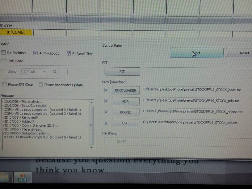

I upgraded to the S2 a while back and gave my mom my prevail. When trying to set it up, they told her it was messed up and needed to be sent in and worked on before they could connect to it. I'm paraphrasing what she told me there. I assumed this was because it was running CTmod and was rooted and stuff. So, when trying to flash it back to stock, it doesn't work. Any help would be greatly appreciated. uploadfromtaptalk1363752416688.jpg
I upgraded to the S2 a while back and gave my mom my prevail. When trying to set it up, they told her it was messed up and needed to be sent in and worked on before they could connect to it. I'm paraphrasing what she told me there. I assumed this was because it was running CTmod and was rooted and stuff. So, when trying to flash it back to stock, it doesn't work. Any help would be greatly appreciated. View attachment 51292
That's obviously not the correct version of Odin. The correct version (provided in the Odin dls for the prevail ) doesn't have a spot for 'pit' it has a spot for .ops
Using the correct version will solve your problem :)
I have been searching for the link to the correct version of Odin and can't find it. I even downloaded the ff19 from the rom sticky page and it didn't have it in the zip either. Anyone willing to link it for me? Please and thank you.
Never mind, I found it buried in the "for dummies" post. I would think there would be a link to it in every major thread that involves flashing a prevail, but that's just me. :-)
