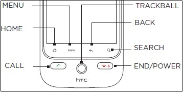

lol, I think folks are just letting go of VOL-UP too soon? I've seen this a lot, so its common, but I think its just a matter of releasing VOL-UP too early:
FWIW, when I boot into custom recovery, I:
1. power-down the phone
2. press and hold VOL-UP
3. press the power (red/green END/PWR) button (still pressing VOL-UP)
4. release the power (red/green END/PWR) button (still pressing VOL-UP) when I see the phone powering-up
5. finally releasing VOL-UP once I see Amon_RA's recovery menu

Note: the power button (red/green END/PWR) is on the bottom right of the phone: eris-front-bottom.jpg
Just wanted to thank all for helping, I had the issue where Vol Up - End did nothing.
But by pressing End-Call (green-red) and then selecting Recovery, it booted into Amon_RA's recovery where everything else went as laid out.

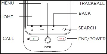

Note: the power button (red/green END/PWR) is on the bottom right of the phone: View attachment 8718
I had the same problem. Holding down the power on and vol up buttons wouldn't bring up the Amon stuff. So, I did the Unlockr method
theunlockr.com/2010/03/16/how-to-root-the-htc-droid-eris/
Then, I was able to do the root one root two install and get the Amon screen up. I bet HTC did something to block this in the latest update. Use a good backup program and you retain most of your stuff and settings. I then flashed it with one of these kernals to get overclocking.

[B][FONT=Courier New][COLOR=green]Build : RA-eris-v1.6.2[/COLOR][/FONT][/B]
