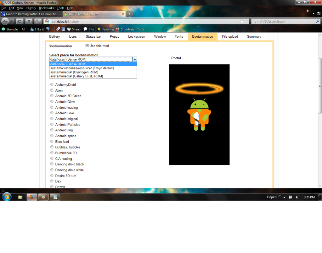

Be careful when selecting the place for your bootanimation.
We have a Cyanogen based ROM. Choosing the wrong location will result in a bootanimation that can't be changed later (without jumping through a buch of hoops! Solution at the bottom of the post.)

Again, with 7zip (or similar) open your theme zip file. Navigate to /system/media where you'll find a file named bootanimation.zip. Guess what that is? :) Overwrite this with your custom file renamed to bootanimation.zip. Now you need to resign your zip, or it won't install.
Have a boot animation that just won't go away? Tried flashing new themes, and boot animation changers with no effect?
Use ES File Explorer (or similar) and navigate to /data/local. Delete the bootanimation.zip. Reboot and enjoy!
