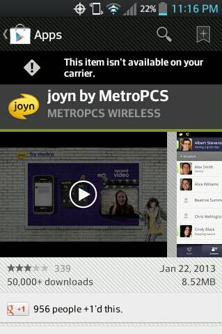

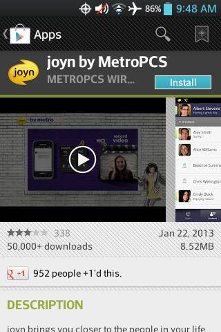

O.o for some reason I can't download it from the google play store either:
Doesn't Joyn have to connect to 4G to sign in, which CM10 does not have working? Or am I missing something?
If Joyn works then that should (soft of) solve the SMS issue...
What if we install joyn on stock, and register it with the 4g. Then titanium backup the program, and restore the backup on cm10? Just an idea
I forgot to pay my bill a day has past before it expire i got joyn and it still works with airplane mode and just enabling wifi

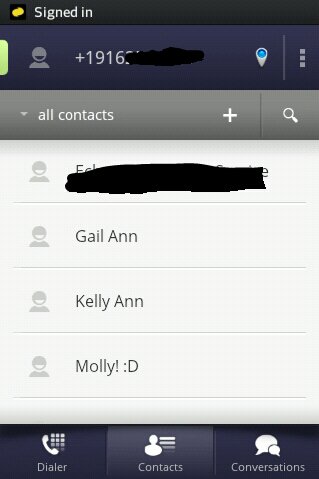

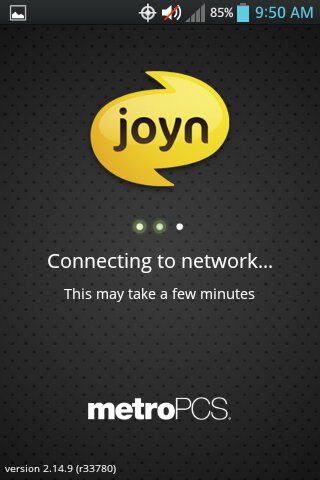

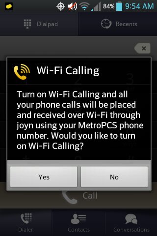

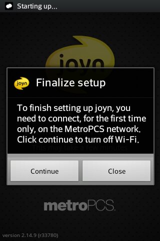

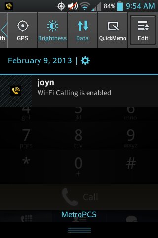

Would you mind sharing how you got Joyn to work on 1x? I remember I tried on the stock ROM, and got some 'could not connect' message.
Does it allow you to do the itinial connection, and message over 1x?
Just be on WiFi, then open it up, after a little it will say something like "you must disconnect from WiFi to continue". Press OK. It should close the app. At this point, you can disable WiFi and turn on your 1x/3G then open up Joyn and let it do its magic :)
