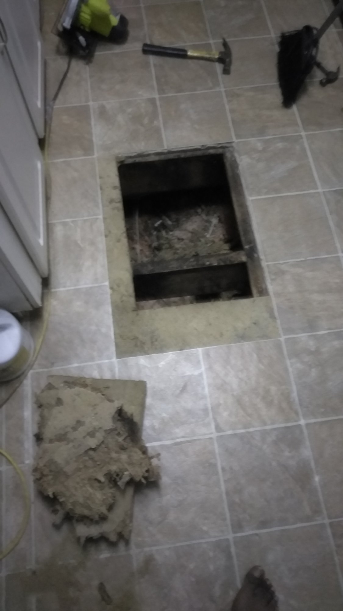

I unzipped the file awhile ago. I'm just not experienced enoughAm I the only one working on the suggested fastboot SSL? My 1st flash failed cause I used a modded 256gb sdcard ( the phone support up to 125gb and any spec sheet that says 256 lies.) It said due to file size not matching something but I'll report back in a jiffy after I try flash again with a compatible sdcard.. I just swapped the patch and system files from the OTA.. I'm fixing a floor at 2:30 am while I contribute..
